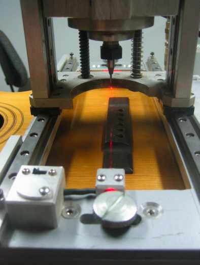

My mill is of a different design, but here's a few shots. The main
points are the same (1/4" shank lam trimmer cutter, linear
bearing travel and plunge, width and depth stops) with a
slightly different layout. Here is a top/side view on a new bridge
I had to slot this morning.
05_223330_bm1.jpg">
I know it's a bit silly and superfluous, but I just couldn't resist
taking the bulb and lense from a cheap laser level and
mounting it on the carriage.
05_223530_bm2.jpg">

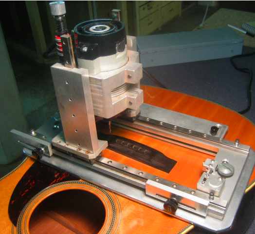

Here is the back with a lead screw for plunging on the right, a
depth stop in the middle, and a spring balance with a lock lever
on the left which I never really use.

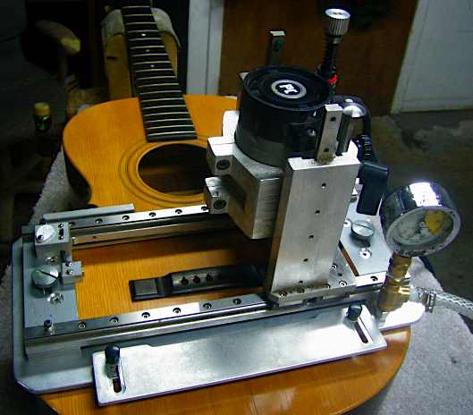

05_223740_bm3.jpg">
This is a shot of the other side with a view of the end stops that I
use. This slot I had to widen out and clean up this afternoon.
05_223943_bm4.jpg">

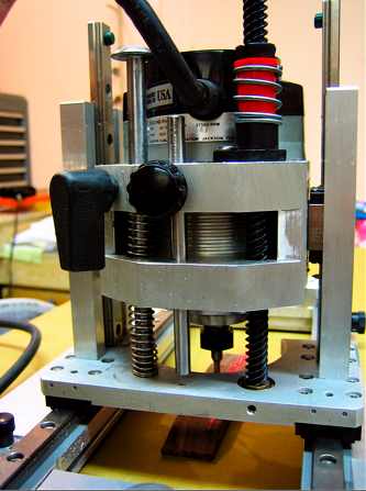

And on the front side put another stop for odd width slots that
may require moving the carriage for a second parallel pass.
05_224141_bm5.jpg">

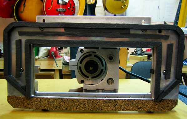

As to the flexing of the top when it is clamped down, I've haven't been
too concerned with it. The base is flat with about 1/2" of padding to seal
and fit contours, but under vacuum It locks down very firmly and will
indeed flatten a top slightly. Still, I don't think any significant or
measurable amount of flattening occurs to the bridge itself that could
result in a curved slot. At the 2 1/2"-3" span where the slot is set you
have a thickness of about 1/2" to 9/16" of maple spruce and ebony
laminated, and I believe most of the flattening will occur from the wings
outward leaving the saddle region relatively unaffected. It is a good point
to bring up though, and I should probably check the change under
clamping pressure. I have a 4' straightedge with a .0001" dial indicator in
the center that I'll use to check deflection next time I cut a slot.
I was going to post a shot of the vacuum clamping bottom of the base,
but for some reason I can't get the image link to fit on one line in the text
box today. Maybe I'll try again tomorrow.
PostPosted: Mon Apr 09, 2007 12:32 pm
Posts: 2060
There, I got it to work.

Thanks for posting that bottom shot with the vacuum seals. I built one of
the Joe Woodworker vacuum clamping systems but have yet to fully
integrate it into my shop. Again being an eBay scroung-o-holic I may
have wound up with a vacuum pump that is slightly underpowered for
what I'm asking it to do.
The mill was also a scrounged up project that took on design changes as I
acquired the parts. I built the base and attached the rails before I found
the slide way that controls the up and down motion. Once I had all the
pieces and a pretty good idea how I wanted it to work the assembly was
not too difficult. I did not spent much time milling very piece to a fine
finish, basically I ground and filed off the band saw marks and rounded
off all the sharp edges and called it good enough.
This was basically my first real machining project and I have a lot more to
learn. Watch out, machining is as addictive as lutherie!
If I had to estimate a budget in terms of money and time I would say
$150 in parts and about 6 hours work. If I were to build it again I could
probably cut the build time in half but the parts budget would depend on
what's available to scrounge this week.
This may be common knowledge but for those of you thinking about
building a rig like this or something else; aluminum cuts at the same
speed as wood. Your blades will wear a bit faster but you can work this
stuff on the band saw, table saw, drill press and sander you already own.
